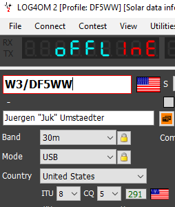

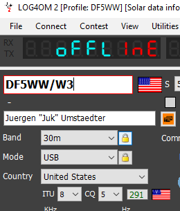

By the way ... Call/W3 should set the country to USA and also W3/Call. In the past it was the thing
that the Prefix of the guest country stays ahead of the call. Meanwhile it´s behind but a lot of guys
like to entreing older contacts from paper logs. That means that the result should be the same.
Just when i writing this and have tried it wit my own call. Both resulting in United states and that´s
correct as it is ...
