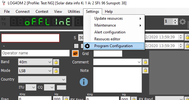

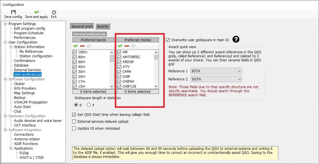

DB9CR wrote: 05 Dec 2020, 13:33 Under Configuration, Program Settings, Edit program Config, the "Edit progrram config" button is grey and nonfunctional.
Not sure what your looking at but that is not our menu, it should be as below
Re: Mode selection in main screen incomplete
Perhaps if you post a screen shot of your program config we can workout what you are doing?

Ok, I was blind.. that's what I was lookign for. Thanks for pointing me into the right direction.
