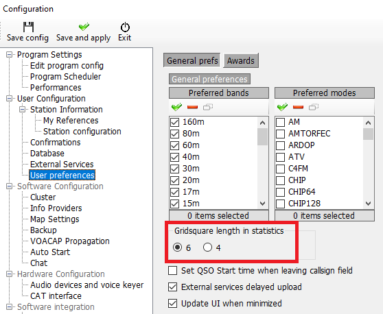

Did you have set 6-digits in the Log4OM setup ?
Hello Juergen, I just checked.. Mine is set to 6 so I do not know why only 4 are being logged :-(
John
<EDIT> I just noticed that none of the 'Prefered Bands' were ticked, I have now selected the bands and I think that has fixed it for me. Thank you
<EDIT No2> no, this did not fix the problem, and like Nolan said, only 4 digits are in the 'prompt to log' pop up panel from wsjt-x... so it appears that it is a wsjt-x problem.
