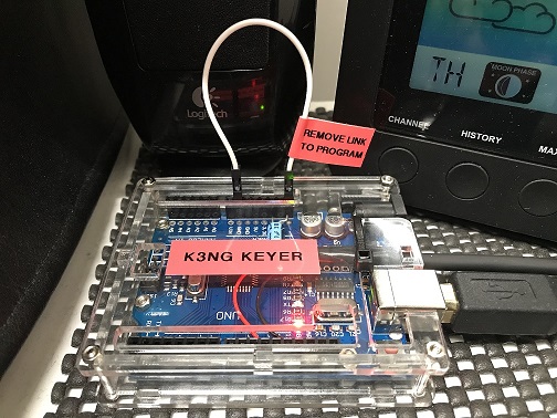

Re: Winkeyer interface
FYI - I use an Arduino Winkeyer emulator by K3NG which works FB with Log4OM
They're easy to build and setup with a total cost of around £10.
73 de James G0UJA
