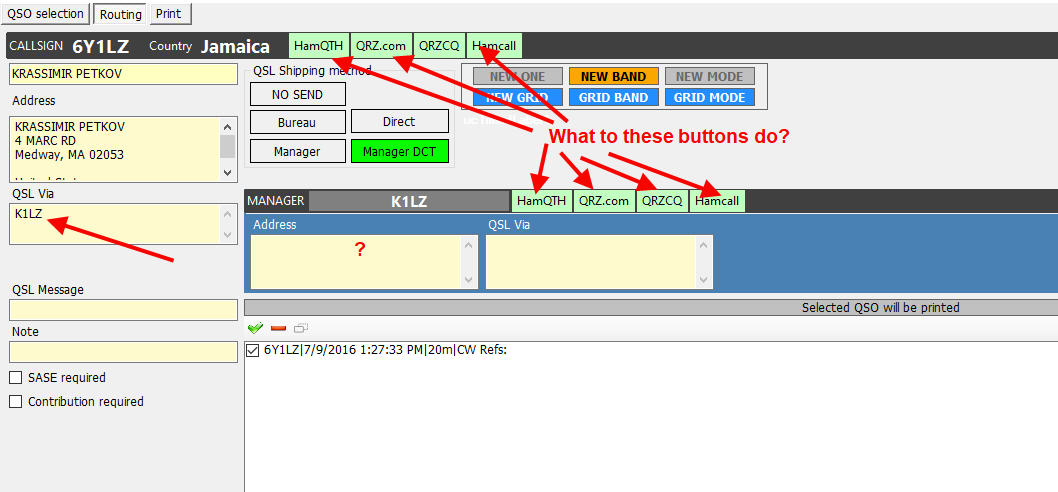

I have the list imported into Log4OM. When I run Label Print and select all the QSO's I want printing, I run through the Routing tab. Why does the program select Manager DCT instead of Bureau for QSL Shipping method? In some cases it picks Bureau but not all the time. What does the green buttons for HamQTH, QRZ.com QRZCQ and Hamcall do in the upper bar and in the Manager section? I press QRZ.com and a red "NO DATA FOUND" appears at the bottom left of the screen.

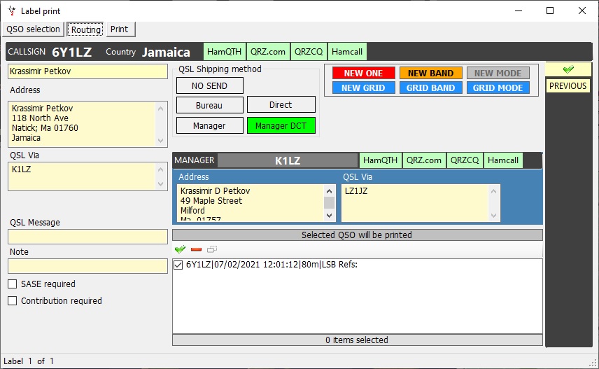

Another example, I have 6Y1LZ (Jamaica), that requests QSL Via K1LZ. The Label Print program has "Manager DCT" GREEN on this QSO but there is no address for the K1LZ manager listed in the Address or QSL Via area. Is the program supposed to query QRZ to get the mailing address of K1LZ? In this instance, since the QSL manager is in the US I wouldn't send this to the Bureau but would directly mail this myself so the address of K1LZ would need to printed. Does this program print the mailing labels too or just the QSO confirmation data? Below is a screen shot of this case.
You really need to be more bold and try clicking on buttons to see what happens, you cant do damage and can always exit the app
The lookup buttons across the top look up the call sign of the other station and fills in the data, accuracy depends on the data that the other station has provided to QRZ, HamQTH etc
The lookup buttons above the manager pane lookup the managers address details and fills in the data so that the labels can be completed correctly.
See the result of clicking the QRZ button shown below, I thought I had covered this in the video's, did you watch to the end?
Dont forget that to get a full lookup from QRZ you MUST be a paid XML subscriber not just a HAM Member

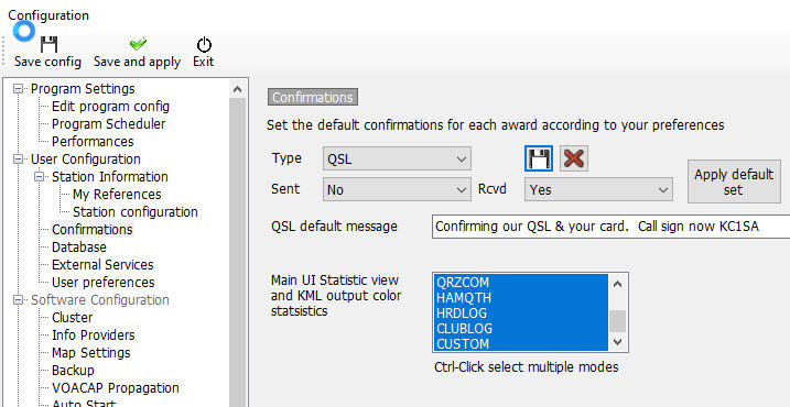

The only message printed for comments is "TNX QSL". I've put other messages in the configuration area but they never print. Any idea?
