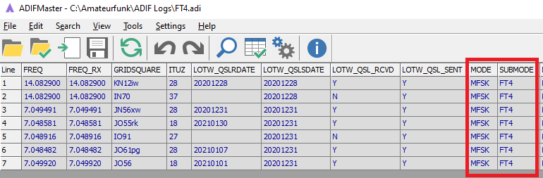

please use QSO manager and searcg with the filters for FT4 QSO´s "Mode equals FT4". Select a few of them
and export them as ADIF. Check the ADIF for stored submode or not. If it´s there uploads to eQSL should
be correct.

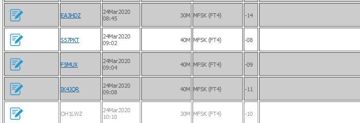

Check at eQSL Outbox your uploaded FT4 contacts. Mode must be "MFSK (FT4)" if so all is correct at your
side. If only MFSK is stored at the eQSL site and your ADIF export shows the Submode correct something
must be wrong at the eQSL site.
