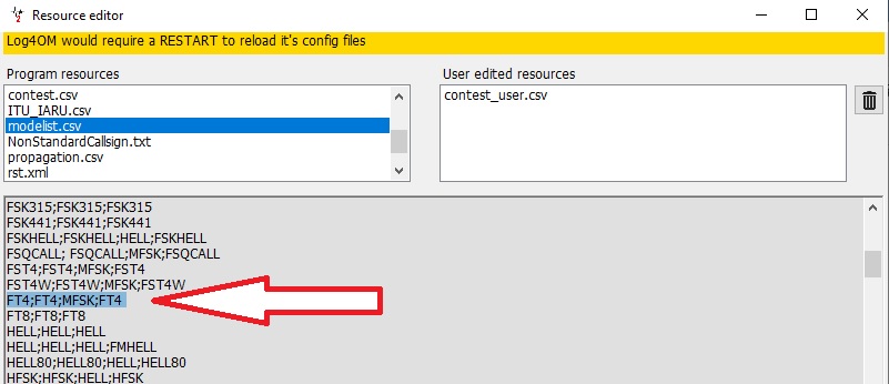

Re: FT4 - FT8
Works fine for me
Are you certain its configured like this in the Settings/resources editor?

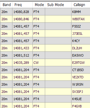

Re: FT4 - FT8
Post by F6FLU »
Yes Terry I use the same configuration
but what you show is not the same presentation as me, as I said I will want to display the submode in the log, there you do not show the submode
Dan - F6FLU
https://F6FLU.org
Re: FT4 - FT8
It is the sub mode, the mode is MFSK
If you want to change the column title to sub mode you can but most people refer to it as mode!

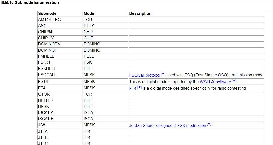

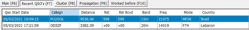

If you modify in the way you request it will corrupt the ADIF export which will no longer conform to ADIF standards
This is an extract from the ADIF format found here http://adif.org.uk/311/ADIF_311.htm#QSO_Fields
If you have a QSO in MFSK then the mode will display as such see below a test MFSK QSO just added to my test log
