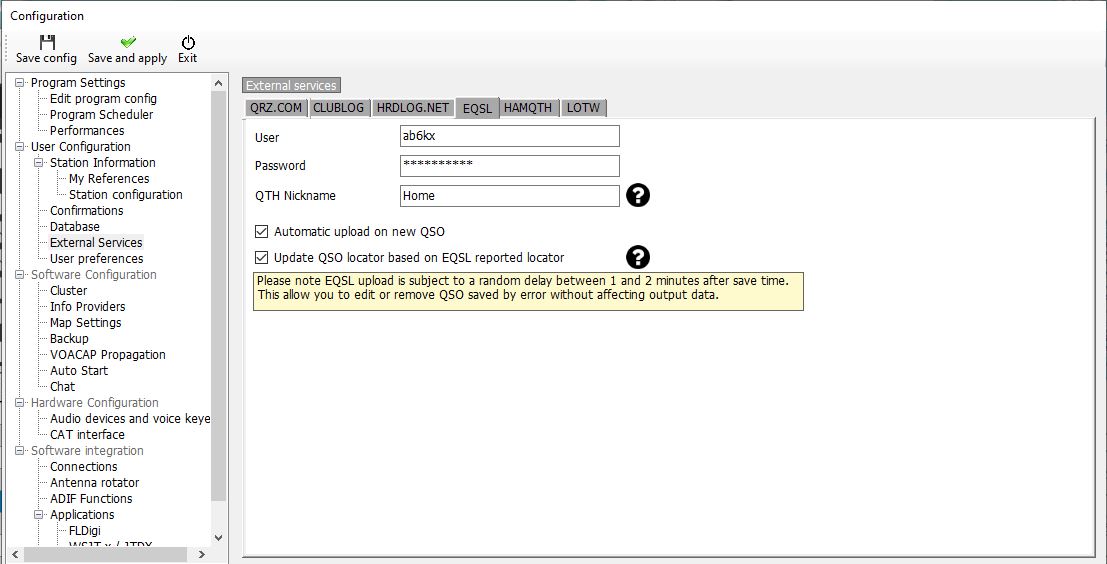

I have been using Log4OM V2.11 with no issues for a couple of months and auto upload to both eqsl and lotw have been working great. of course lotw uploads on program close and eqsl has up to recently uploaded within a couple of minutes of a QSO. I get no error, I just see that QSL status is sent = N on recent qso. I can manually upload via Log4OM and download on demand so I know that the username and passwords are correct. Any assistance you can give would be great as I have loved this feature. See config below.

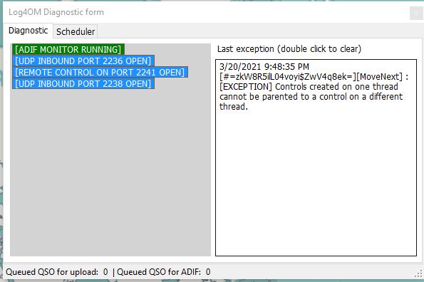

I opened the diagnostic page to see what happens after logging a qso and found this exception.
