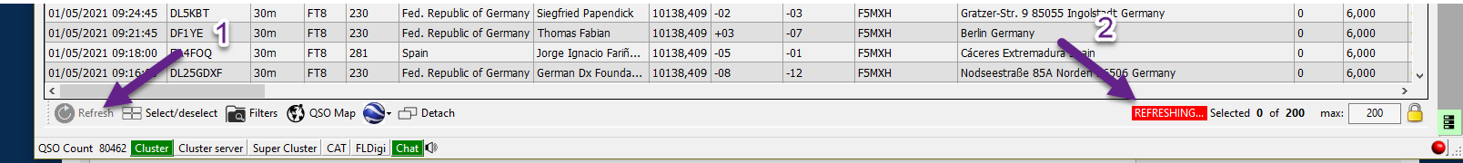

I've just upgrade to 2.13 and the refreshing seems to be very long : 1'31" Back to 2.12 same refresh : 14"
I didn't make test with the portable edition.
I have the same results (not exacly the same time) on 3 differents computers.
Is it only at my QTH or is someothers have the same problem?
73 de f5mxh
A way long Refreshing on V2.13
Re: A way long Refreshing on V2.13
Same result if:
- You hit the refresh button,
- After external loging (ie: jtdx or wsjt).
1: push this button
2: refreshing
1: push this button
2: refreshing

In the program config/performance tab try unchecking the three check boxes and see if that improves things
Nothing significant!
