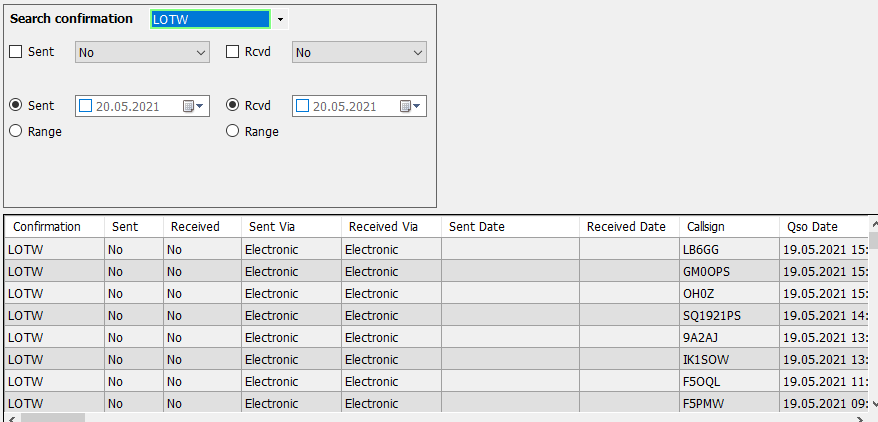

I'm using the intermediate build 2.13.0.3 which you sent me re the awards issue.
I notice that with this build, it sends/uploads my LOTW log/adif file to LOTW without issue.
But now, with this build, it does not go back and mark the QSOs Sent. They remain 'requested'. I have to manually go and update them sent. Whereas previously, a restart of LOG4OM showed them as sent.
regards
Alan
PS - it also keeps reminding me that 2.13.0.0 (an earlier build) is ready for download.
Re: V 2.13.0.3 LOTW not marked as sent
I can confirm this for 2.13.0.3. Also not sended after close. A manual upload from
QSL Manager works fine. Automatted upload on close is set, no changes to earlier
versions.
Have a lot problems with Skype so can´t inform the Team via this way at the
moment but shure that Terry reads this.
