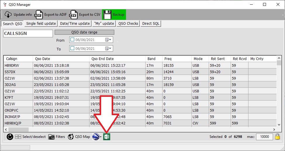

How do you export to Excel?
Posts: 11593
Re: Band Not in Printed Log
ka3qot wrote: 06 Jun 2021, 22:15 How do you export to Excel?
Page 58 of the user guide plus the Excel button on the bottom or edge of mist lists like QSO Manager, Recent QSO's etc
