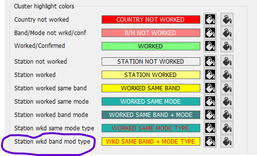

i have some additional information for you.
during my test yesterday I saw that a new QSO which I saved then did get the correct cluster status.
The QSO's already present in my database get the wrong status in the cluster view if the station in question has a cluster entry.
I use LOG4OM daily from about 10:00 in the morning until late in the evening / midnight because of the beautiful cluster display and the alarmsettings that I have set to monitor specific stations like for example all WRTC (II0WRTC, II1WRTC, etc) stations. Because of this, I immediately noticed that the cluster status is not displayed in the correct color. Normally I can immediately see by the color if I have worked a station on the particular band with the particular mode, this is perfect.

I also installed the Beta 2.21.1.1 it did not fix the problem for me. it is still showing the wrong color
