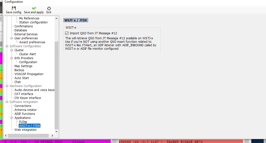

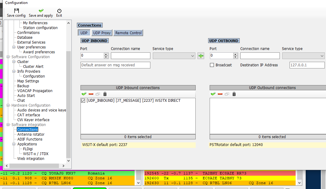

On WSJT-X settings, UDP server is checked, not ADIF broadcast.
On LOG4OM settings, JT_message ( port 2237) and application settings, JT message #12 is checked

settings are like this:
Ekran görüntüsü 2022-07-03 222720.png (50.73 KiB) Viewed 4065 times
Ekran görüntüsü 2022-07-03 222701.png (63.31 KiB) Viewed 4065 times
Ekran görüntüsü 2022-07-03 222447.png (125.87 KiB) Viewed 4065 times

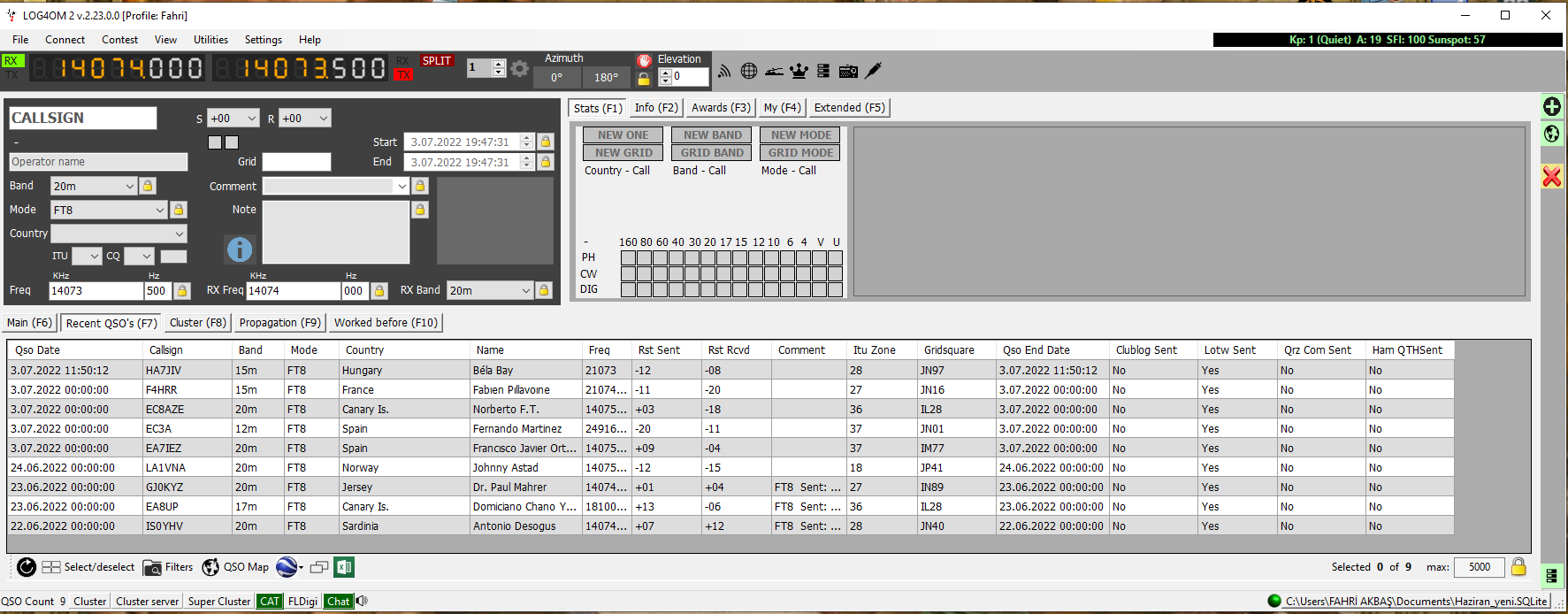

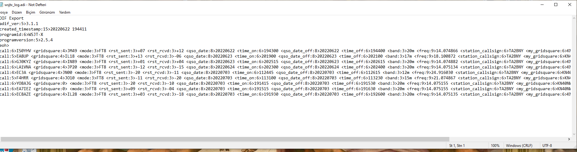

adi file and LOG4OM QSO page is like that: ( the only time correct line is entered manually)
I am using windows 10 Turkish language version, programs are English. Could there be a language conflict problem? This is the only thing I could think of. Think I tried every possible scenerio...

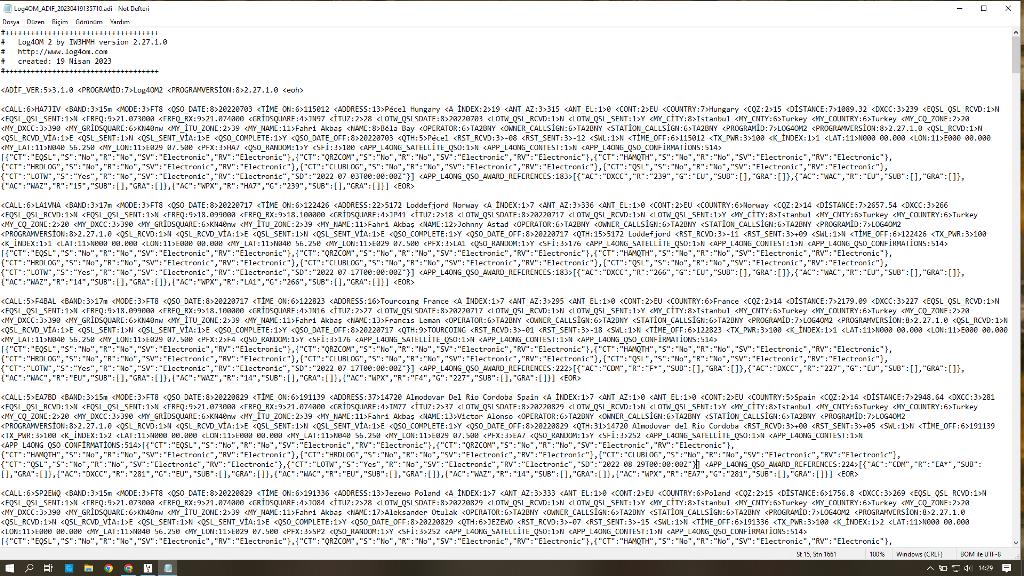

Hello again,
My problem still continues. During this time I logged all qso's manually. Then I realised that log4om adif export is problematic for me. Wen it sends reports to qrz.com time is shown as 00:00, also reporting to LOTW via TQSL, time is seen as 00:00 so it halts. Log4om adif export file seems fine though.
I am very stuck around this.
