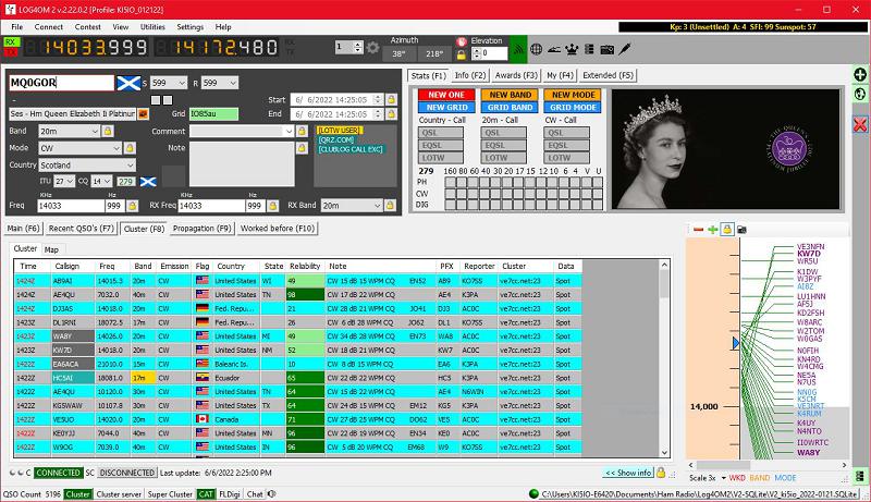

Do you have Clublog enabled for use as an Info Provider in your Configuration?
When doing a lookup with your MQ0GOR call it will show up as Scotland when Clublog is enabled.
I seldom use Clublog and would have expected your call to resolve properly with just QRZ as the data is proper there, but for some reason Log4OM won't let it resolve via just that Info Provide source.
- mq0gor-medium.JPG (105.41 KiB) Viewed 1030 times
