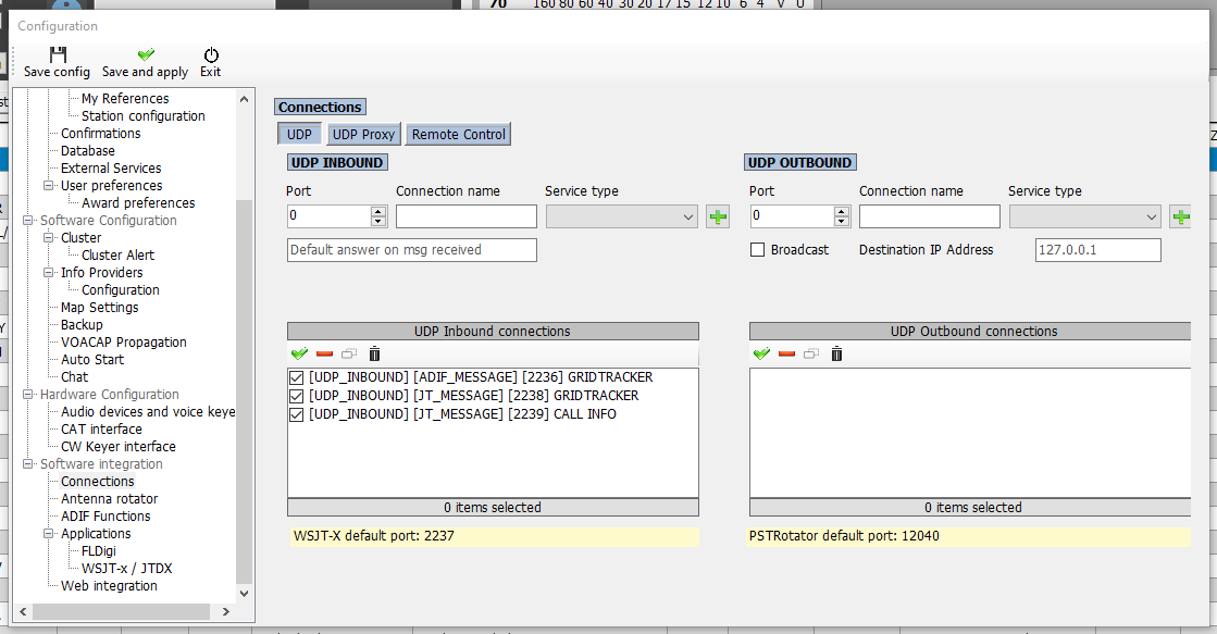

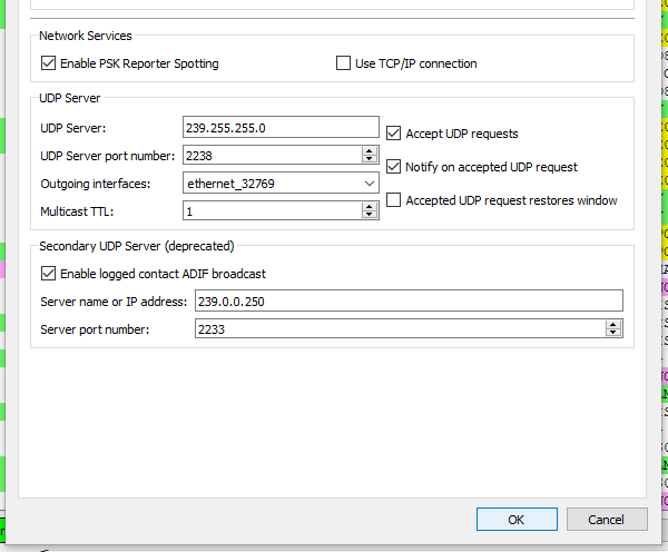

Hi I have Log4OM working great alongside wsjt-x, Gridtracker, and JTAlert except for 1 thing. I have to go into settings and click "Save and Apply" each time I start but after Gridtracker has started before Gridtracker will start receiving information. Once its going it all works great here are images of my settings if there is something else i have to set any help appreciated

You don't need to "Forward UDP Messages" to Log4OM -- it doesn't know what to do with them anyways.
Don't know if turning that off will make any difference.
JTAlert already sends call sign and logging records.

Also why do you have the Secondary UDP Server turned on in WSJT-X? Is something listening on 2233?

w9mdb wrote: 12 Jun 2022, 12:56 Also why do you have the Secondary UDP Server turned on in WSJT-X? Is something listening on 2233?
was following a tutorial on youtube and just copied all settings i could see
