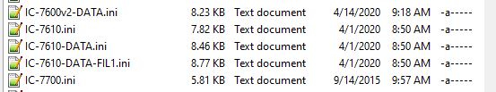

There are 3 different Omnirig INI files to select from. You might select each of them to see which may provide a solution.
I recall another OM having a similar situation here on the Forum. I'll do a search for that thread.
Below is a screen clip of the IC 7610 INI file choices that Alex provides with the Omnirig package.
- omnirig-ini-7610.JPG (25.14 KiB) Viewed 2046 times

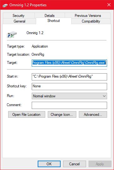

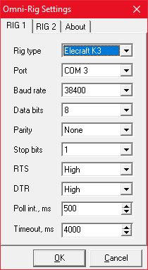

You should have an Omnirig icon on your desktop or available from your desktop 'start' button under a folder called: Omnirig.
Click on that icon to open the Omnirig settings panel and you can then click the dropdown for the Rig Type and then select the other options and give them a try one at a time.
Screen clips below show where the "exe" for Omnirig exists on my computer and also the Omnirig settings panel where I have chosen the Elecraft K3.
- Omnirigsettings.JPG (27.16 KiB) Viewed 2027 times
- Omniriglocation.JPG (32.95 KiB) Viewed 2027 times
