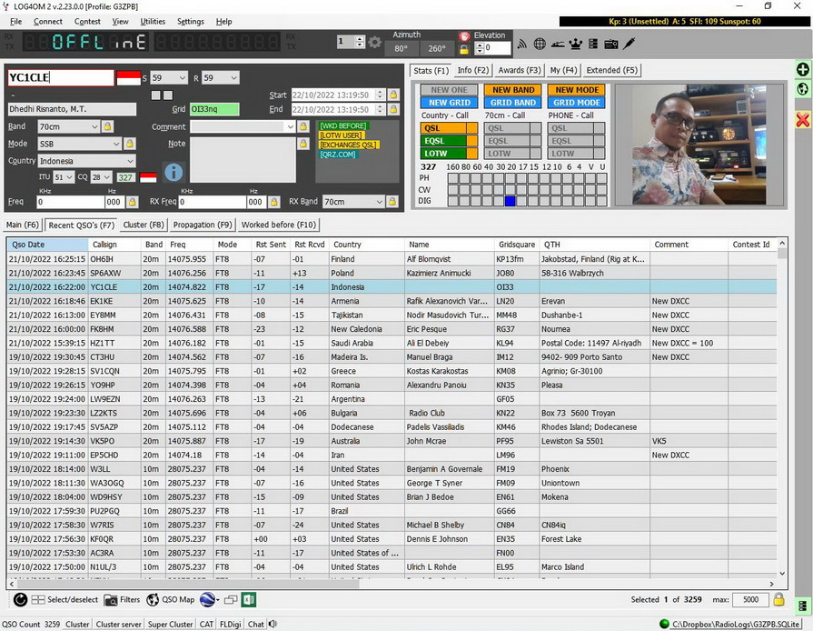

Below is a screenshot of my friend Graham who never sends any form of confirmation other than a card and then only by specific request and as you can see its all working fine. (I am one of the lucky card recipients)

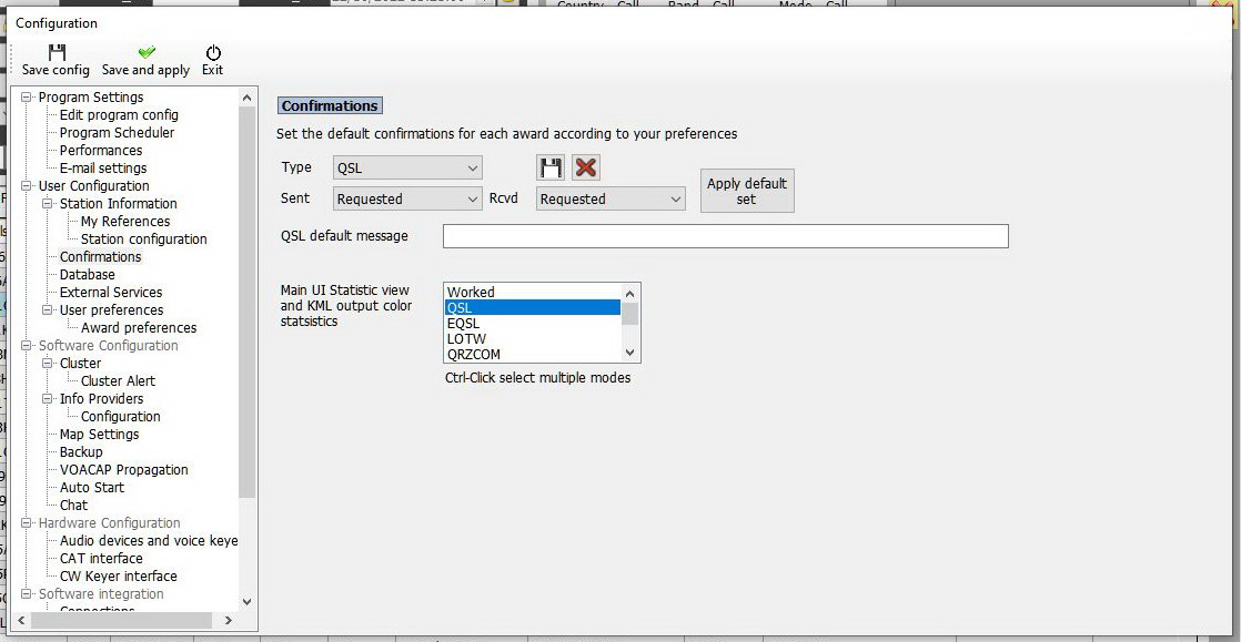

Here are 3 files which I hope will enable you to tell me where I am going wrong...
The system won't let me send an .adi files so I presume I have to send it as an attachment to an email - I will do that.

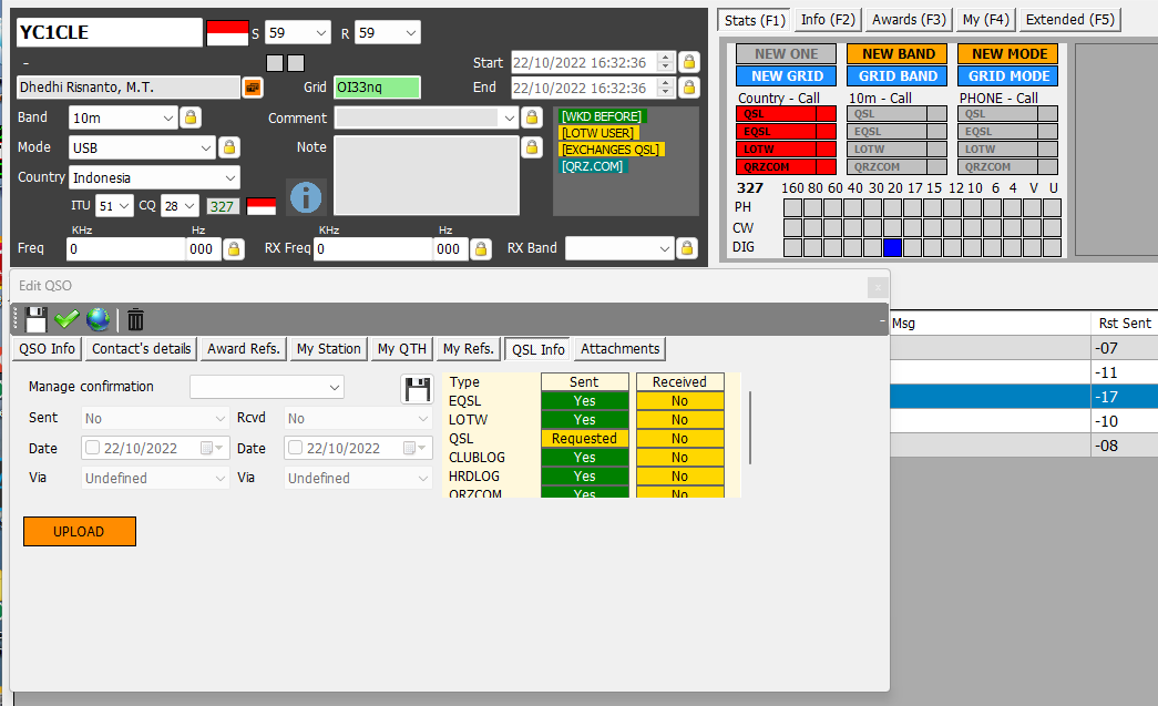

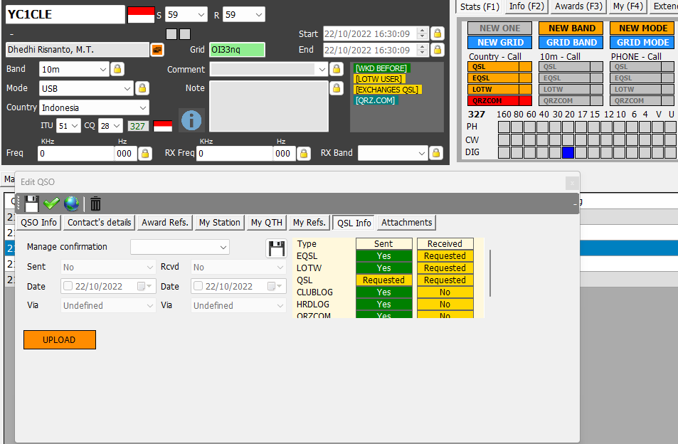

Having loaded the ADIF file that you emailed me I find the reason that you don’t see red for unconfirmed confirmations with specific call signs is because you have the QSO’s marked requested, see original image below
A stated-on page 34 of our user guide ‘Orange = Worked and confirmation is requested’ so the display was reflecting the confirmation status correctly.
If you change the confirmation received status to No then the display is correct, remember that you must restart Log4OM after such changes for the change to be visible. See screen shot below after I marked the QSO confirmation status to No
I suggest that you use the QSL manager and filter on confirmation received status ‘Requested’ then bulk edit them to ‘No’
