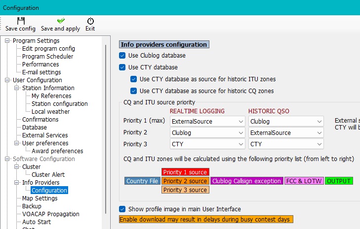

I check with my friend and we 're exaclty same seeting, but when I update field information, CQ ZONE up to wrong zone. I use QRZ.COM info provider and I paid subcription AT QRZ.COM. For exemple, the station K9BM IN CQ ZONE 4, but after update turn at CQ ZONE 5. But grid information it's correct. If I choose other station, for exemple K9CT, it's all information is correct. I ask, if the station was defaut info by qrz.com, I belive upgrade bad cq zone information. I don't understand why this ? If I choose HAMQTH, all station we're ok . I'd like use qrz.com in info provider because I paid the subcription.
REGARDS
SYLVAIN VE2CSM
Re: UPDATE INFO CQ ZONE AND ITU ZONE BAD
ve2csm wrote: 06 Dec 2022, 03:16 If I choose HAMQTH, all station we're ok .
This indicates that the data is incorrect in QRZ so nothing we can do in Log4OM will change that, speak to the other staion or QRZ by email and ask them to correct it

Assuming the user has the order of data lookup correct then the QRZ (External sources) data should be what is shown
The API download data from QRZ 'SHOULD' be the same as displayed on the website, however there have been many instances where it is not the same which causes an incorrect lookup
The fact the user has stated that "If I choose HAMQTH, all station we're ok" leads me to suspect that the incoming data from QRZ is incorrect.
