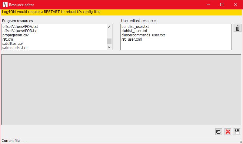

Jan,
You can edit the rst.xml file to suit your needs.
You can reach the Resource Editor at: Settings / Resrouce Editor ... then select the rst.xml file in the left box, make your edits and then tap 'save'.
The modified file will then have the _user extension added to the name. Then close the Resource Editor and then restart Log4OM and your now edited rst_user.xml file will be recognized for use.
