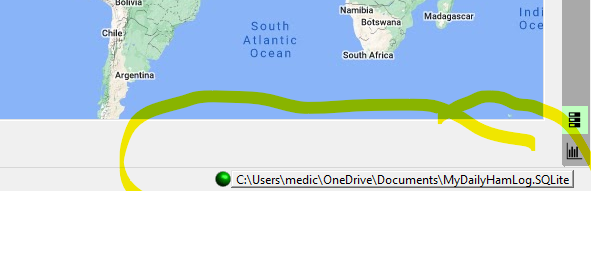

G4POP wrote: 04 Jan 2023, 22:36 Are you connected to a database- see bottom right of main window for path to database or message 'not connected'
Yes if what I circled in the snapshot is what you are referring too

Re: Cannot save QSO's
So you enter a call and it does a lookup and then you save by what? Enter key on keyboard or Plus icon on right side?
Do you see any error message?
Have you checked the logfile for errors?
What is the Log4OM version number?
so what happens when you try to save a qso? Error message or what?
I suspect one drive is causing the issues can you move your database to a physical location or Google Drive?

G4POP wrote: 05 Jan 2023, 08:49 so what happens when you try to save a qso? Error message or what?
I tried that just now working so far. Thanks for helping my friend 73's Jim
n3se wrote: 05 Jan 2023, 13:37
Windows security limiting writing to one drive after an update of Windows, had this before
