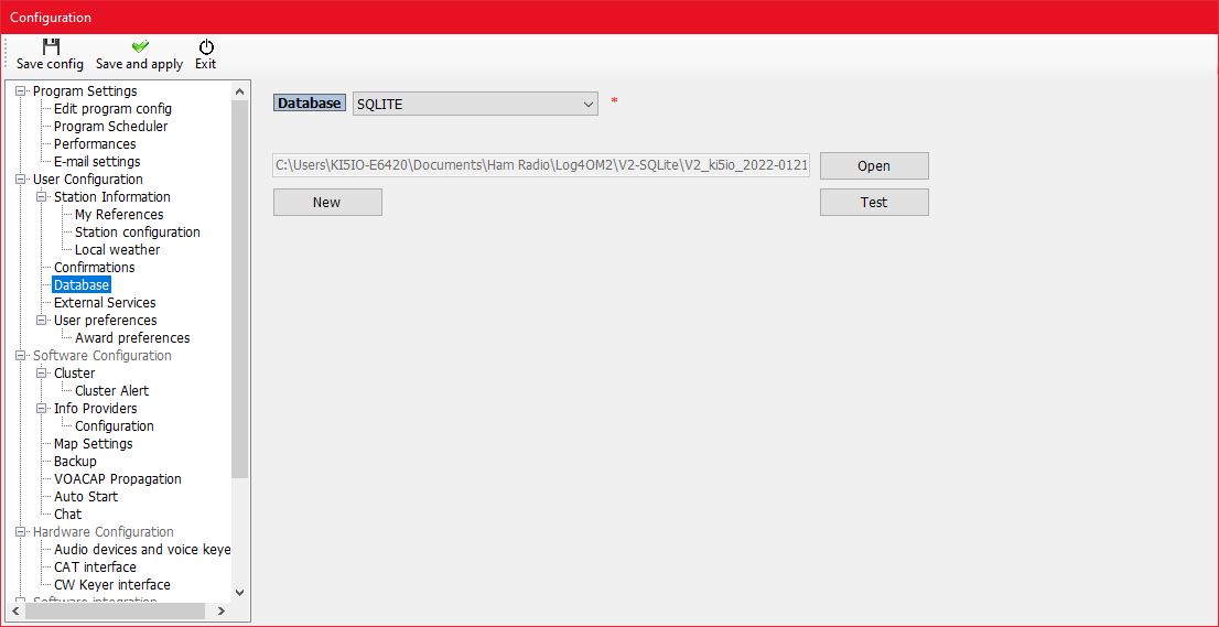

Just going to step through what I do when changing to a different d/b.
I go to: Settings / Program Configuration / Database
Then I tap the 'open' button and select the new d/b. It does an auto 'test' of connection to the d/b, but I always tap the 'test' button to double-check.
Then I tap the Save and apply button that will close the Program Configuration panel. Then I restart Log4OM.
Even after the Program Configuration panel closes the d/b name changes and appears to the right of the green globe at the lower-right corner of the Main UI.
I think that is what I got from your post, but maybe you were not tapping the "Save and apply" button.
