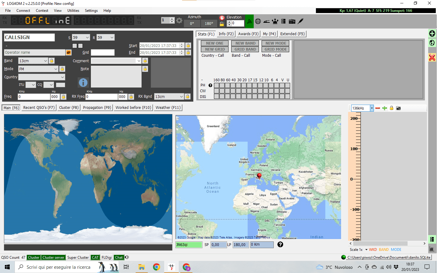

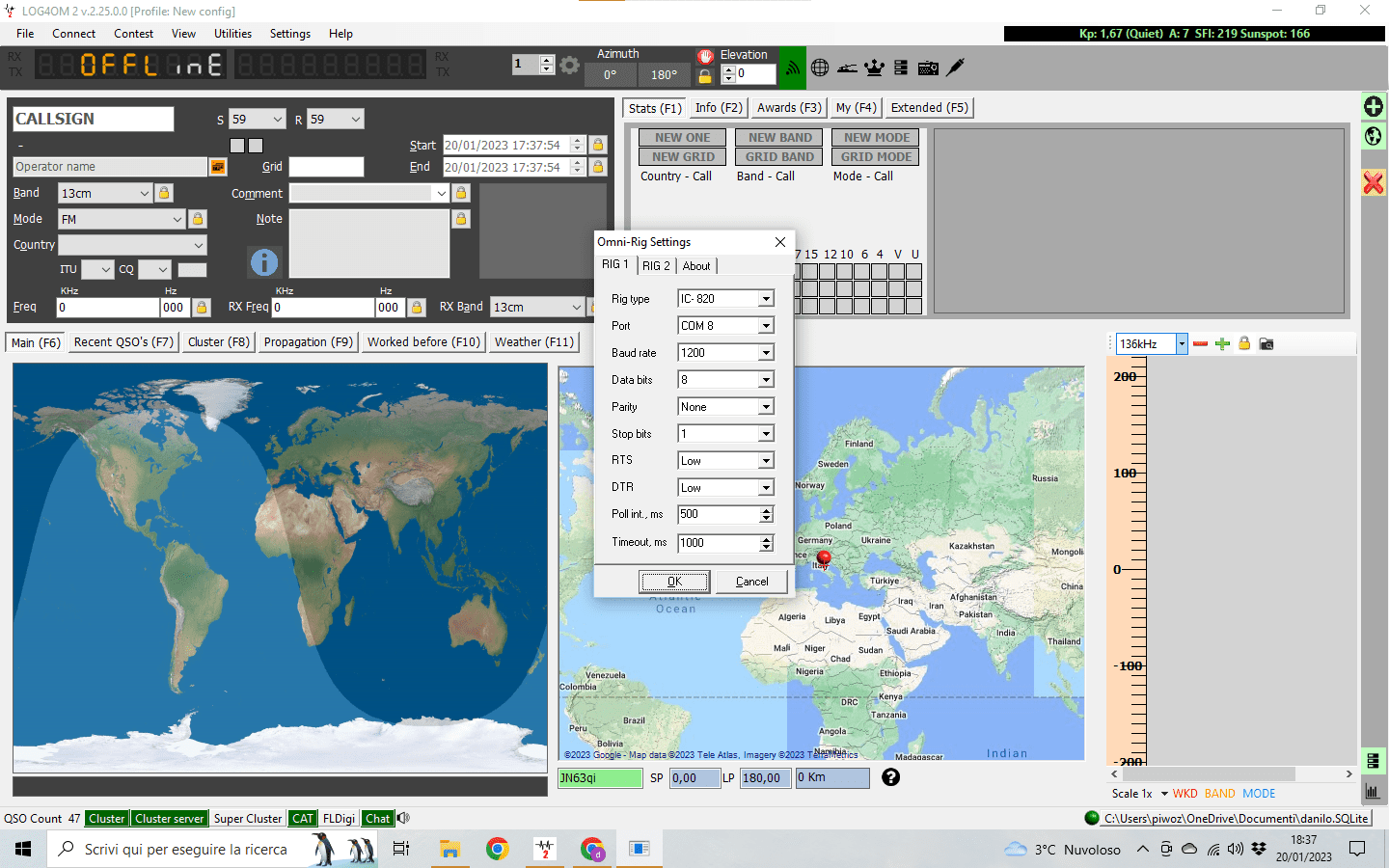

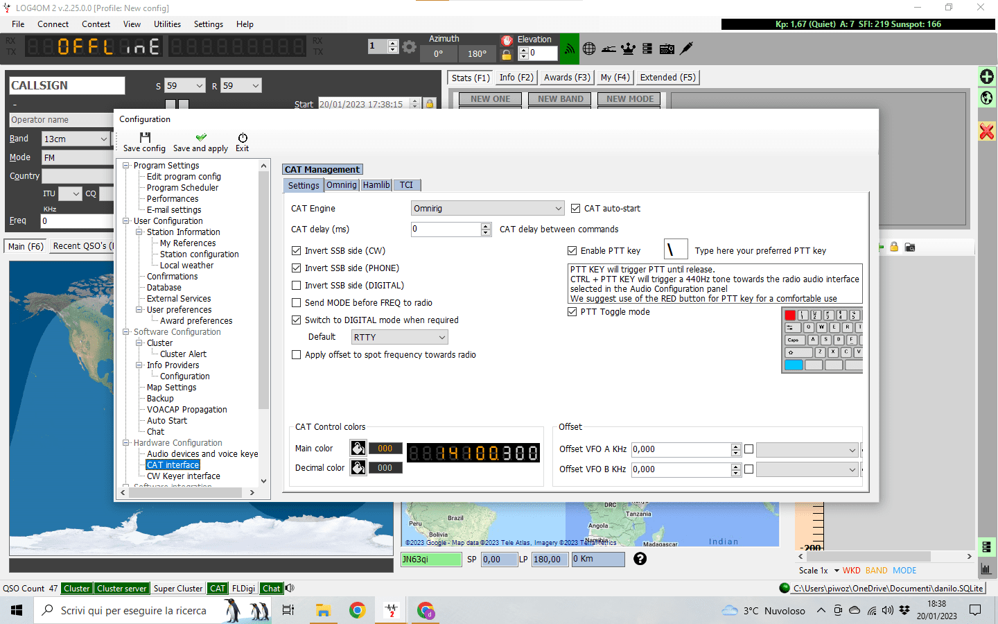

Immagine 2023-01-20 183821.png (89.92 KiB) Viewed 4095 times
Immagine 2023-01-20 183801.png (177.54 KiB) Viewed 4095 times
Immagine 2023-01-20 183741.png (189.73 KiB) Viewed 4095 times

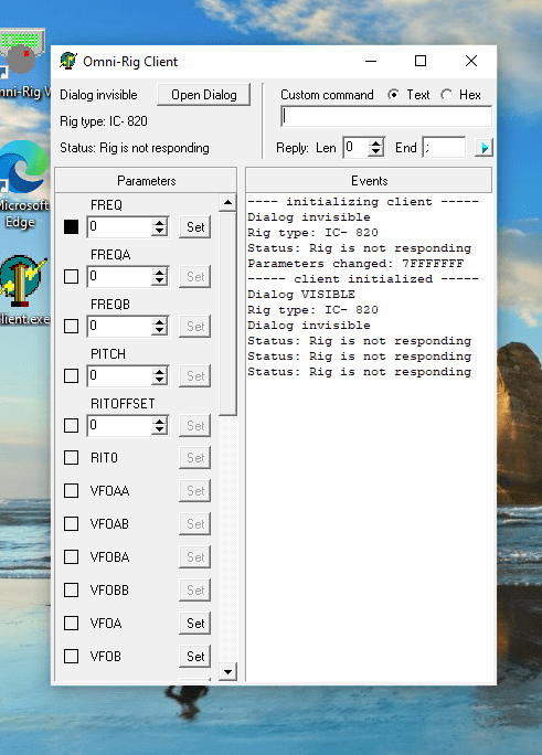

.....client
Immagine 2023-01-20 183930.png (51.53 KiB) Viewed 4095 times
Immagine 2023-01-20 183851.png (50.89 KiB) Viewed 4095 times

If OmniRig Client is not connecting, that indicates that the issue is not with Log4OM.
In any case, are you starting OmniRig as Administrator? When you tried Client, was Log4OM NOT running?
