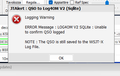

Dear,
I set all program as such as a Log4OM manual page 177 but whenl i put in log on WSJT-X a QSO, JTAlert make a Logging Alert Error, but on Log4OM QSO logged without problem? where is my mistake?

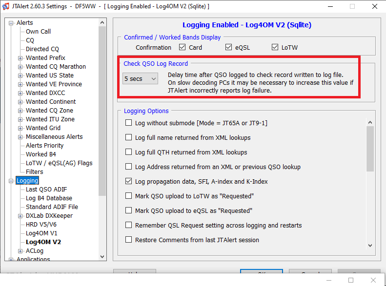

Your mistake is in JTalert settings. Give JTalert more time before it sends a warning like this.

Thanks for your suggestion I tried to increase the value up to 20s but nothing to do my computer is of the latest generation an eleventh generation i7 I can not imagine that it is slow enough to create this problem, one thing is sure that I notice that the QSO is recorded on Log4OM with a certain delay compared to before I would not like it to depend on this new version 2.26.0.0

I checked, when I confirm the logging on wsjtx in my log4om log it is recorded more than 22 seconds later, so jtalert, even set to 20 seconds, returns the error screen. how is this exaggerated delay in log4om logging possible?
