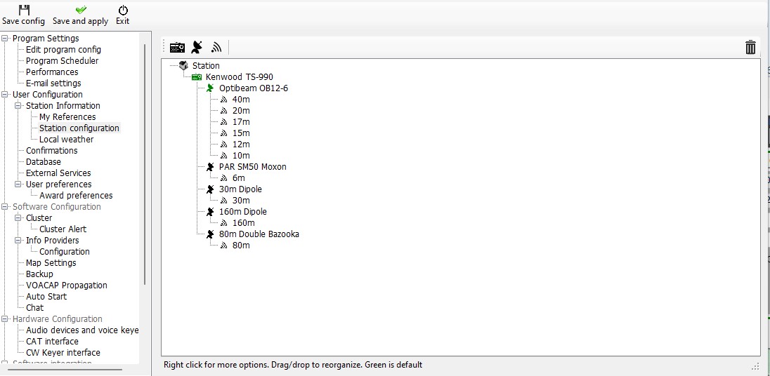

Just another user but here is how I have my station configured and it switches data based on which antenna is in use (for me selected by band).
Station Configuration.jpg (89.71 KiB) Viewed 2084 times
Hope this helps - 73
Larry N1FG
Re: Relate My Station configuration to current band selection
You should mark the antenna as "default for the band" in order to have Log4OM automatically switch to this antenna when band change

Thanks Larry. I did eventually find this and now I use it regularly.
