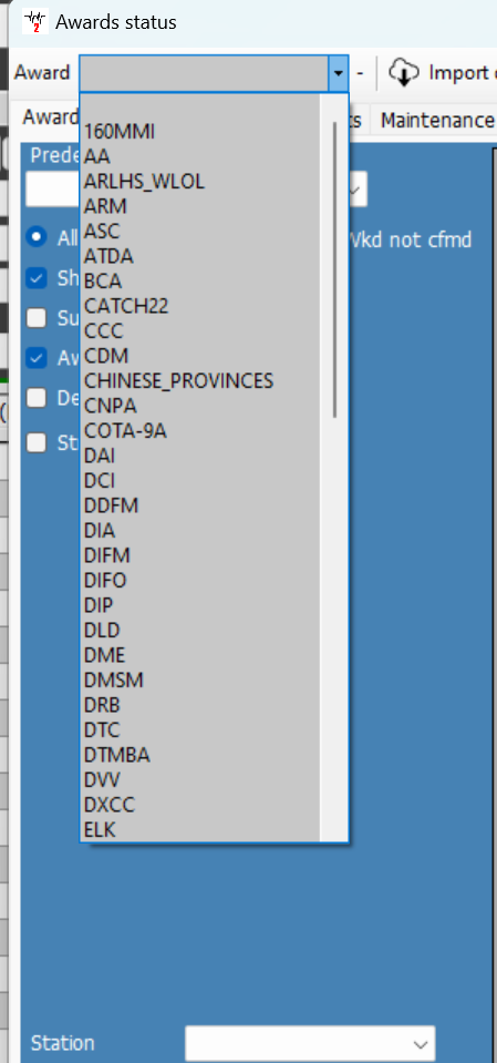

1) Is it possible to only display favourite awards in the award drop down menu on the award status screen ? I am only interested in DXCC and WAS but I have to scroll down the list each time to select them.

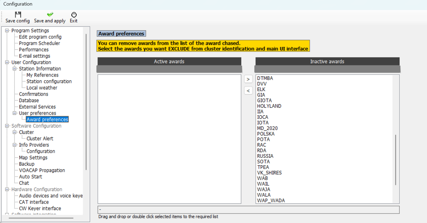

Re: Award status questions
I tried that but no difference. DXCC and WAS still missing.
Even moved all those available across to inactive and they still appear in the drop down list
- Screenshot 2023-03-16 172157.png (245.13 KiB) Viewed 951 times
- Screenshot 2023-03-16 172225.png (91.76 KiB) Viewed 951 times

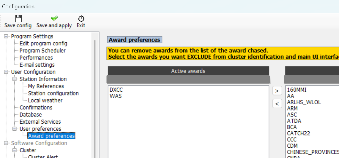

Bingo, that worked thanks.. Needed to use update resources
- Screenshot 2023-03-17 090304.png (154.62 KiB) Viewed 940 times
- Screenshot 2023-03-17 090323.png (48.89 KiB) Viewed 940 times
