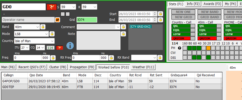

But surely it already does?
I have entered G4POP/GD0 as a QSO
When I type GD0 in the call field it displays the /GD0 contact in the WB4 window as well as GD0TEP, see below
Screenshot 2023-03-26 090411.png (46.89 KiB) Viewed 3392 times

Now...try to search TEP for GD0TEP 8-)

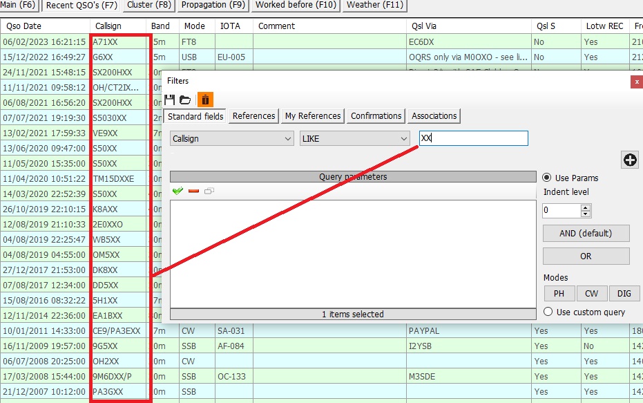

Hi
One idea that could help the purpose:
Within "Recent QSO's (F7) you can do it with the filter:
Use Callsign
log.callssign like %the suffix to look for%"
Please see what I have if I do it for "XX" suffix
73 Manuel Fernando CT1BXX

CT1BXX wrote: 01 Apr 2023, 09:02 Hi
Use Callsign
