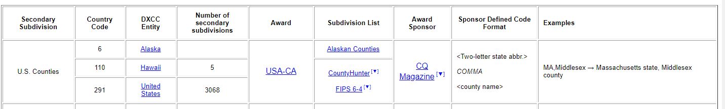

We follow the ADIF standard of the county display: "state abbreviation then county name" and no it won't be changed.

I can only address the county display with this reply.

- adif-counties.JPG (51.6 KiB) Viewed 1238 times

If that's the case with the ADIF format, then why when I import to N3FJP ACL for instance, the state is parsed from the county. The same holds true for importing into Ham Radio Deluxe. I'm not asking to change the ADIF format. But I'm asking that Log4OM can parse the State info out of the County field.

I can't speak for how Scott programs ACL or how the folks at Ham Radio Deluxe processes their data.
Currently (and since Log4OM V1) this is how such has been processed in this APP' environment.
