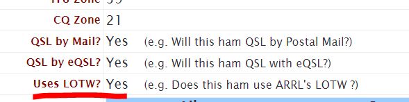

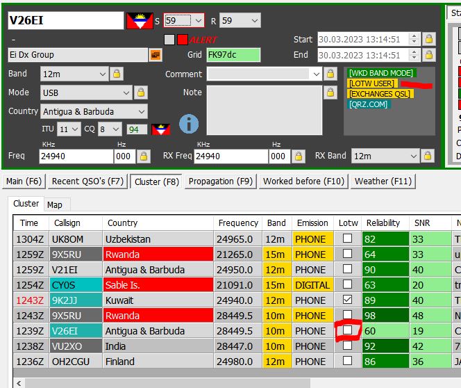

Is this a bug ?

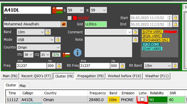

Persistent
A41DL - QRZ

V26EI
QRZ

Roland,
I've been trying to come up with a similar call that appears in my cluster feed, but "so far" I've not been able to experience what you've shown.
Now ... maybe it is related to the cluster you are using?
FWIW - I use Lee's ve7cc cluster feed.
Maybe something is amiss there? I'll keep scanning to see if I can find similar.

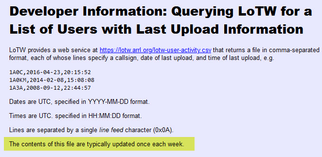

Have you tried updating lotw users in our resources updates

Yep. I did that and also did a search and v26ei is not in that most current updated d/b.
Maybe v26ei is no longer using lotw even though their QRZ.com Detail page indicates they do ??
Their text on the QRZ.com biography page indicates QSL only via OQRS.
Re: LotW inconsistency
Roland,
Another Alpha member just advised he noted that v25ei has just uploaded Q's to lotw today. Their call sign has not been in the most recent d/b files provided by ARRL and hb9bza.
With their recent (today's) upload their call will then again appear in a new d/b list that will trickle down to the cluster nodes and Log4OM as well.
