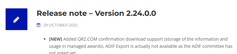

QRZ download confirmations were provided a couple of versions back, and this worked correctly until this last release as described.
ZL3GAV
Posts: 34
Joined: 26 Jun 2022, 08:25
Location: Christchurch, New Zealand
Re: QRZ DOWNLOAD
Post by ZL3GAV »
Note the functionality was available since this release, and has worked correctly until the new release, including the last beta.

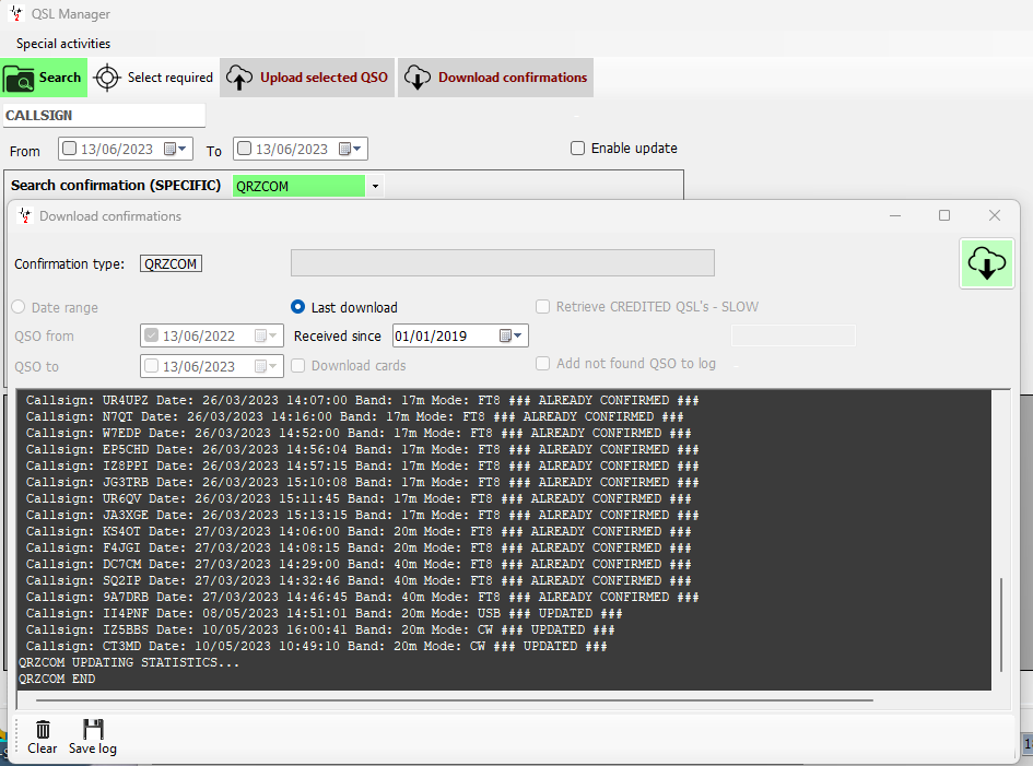

QRZ log.png (21.99 KiB) Viewed 2702 times
Re: QRZ DOWNLOAD
ZL3GAV wrote: 13 Jun 2023, 21:06 Note the functionality was available since this release, and has worked correctly until the new release, including the last beta.
Well it works fine here using 2.28.0.0, see below
Have you checked that your QRZ API Key is OK?
And the updates listed have been done in my logbook
QRZ DOWN.png (91.5 KiB) Viewed 2689 times

Re: QRZ DOWNLOAD
ZL3GAV wrote: 14 Jun 2023, 20:28 Hi Terry
Thanks, no issue with the API key.
I note your download showed the entire logbook sync, would be interested if it works for new QSO's?
Gavin
ZL3GAV
I just checked and downloaded all QSo's from the last download (13/06/2003) and that also worked fine, a couple of new updates.
The previous one shown was not from the start of my logbook it was just from a date I chose for testing and as you can see the QSO's that had not been updated before were synchronised correctly.
Conlusion is that it is working fine for me and I dont think there are any other users having a problem so it must be local to you.
I know you said the API key was OK but it might be worth copy and pating it in again just to be certain?
