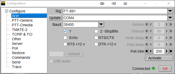

I would like to use FLRig for CAT control of my Yaesu FT-891
And Log4OM using Omnirig if possible. I have used Hamlib with limited success. Hamlib will hook-up and then drop out after just a few seconds. VERY frustrating.
In the other threads that I have found on this subject, Terry suggests Omnirig, but I can't for the life of me figure out how, because FLRig is using COM4.
I'm sure there's a way to all three (FT-891, FLRig & Log4OM) talking to each other! Would someone who's using this (or similar) combination please give me a quick "how-to"?

Thank you, but I have already seen that post. Like I said, Hamlib hooks up and drops out after 5-10 seconds.
I don't understand why this is so hard. It's obviously something that I am doing wrong, but the solution escapes me.
