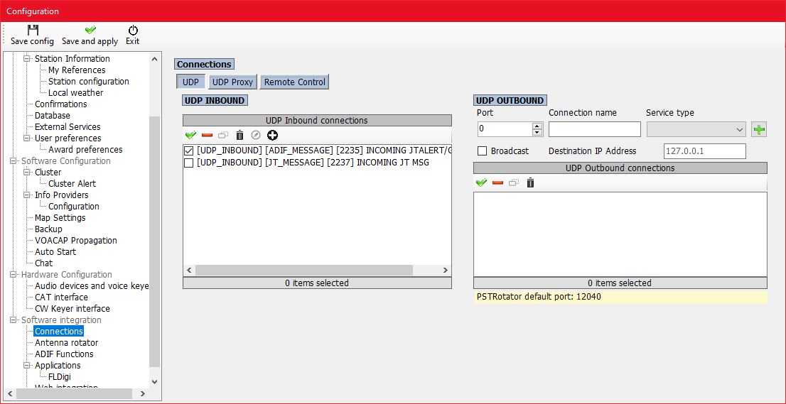

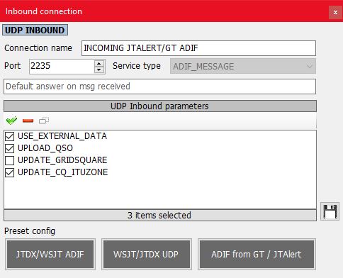

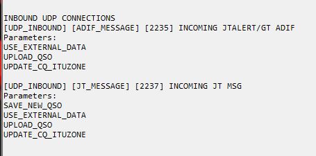

Re: UPDATE_CQ_ITUZONE
Greg,
If you are asking where the "UPDATE_CQ_ITUZONE" label is coming from ... well it is related to the UDP Inbound Connections you have set up for the FTxx mode operations from WJSTx and JTAlert.
I have similar in my Self Care Information. Clips below show what shows up in my Self Care information and I've also provided a clip showing the UDP Inbound Connection that drives such information to be saved.
Is this what you are referring to?
