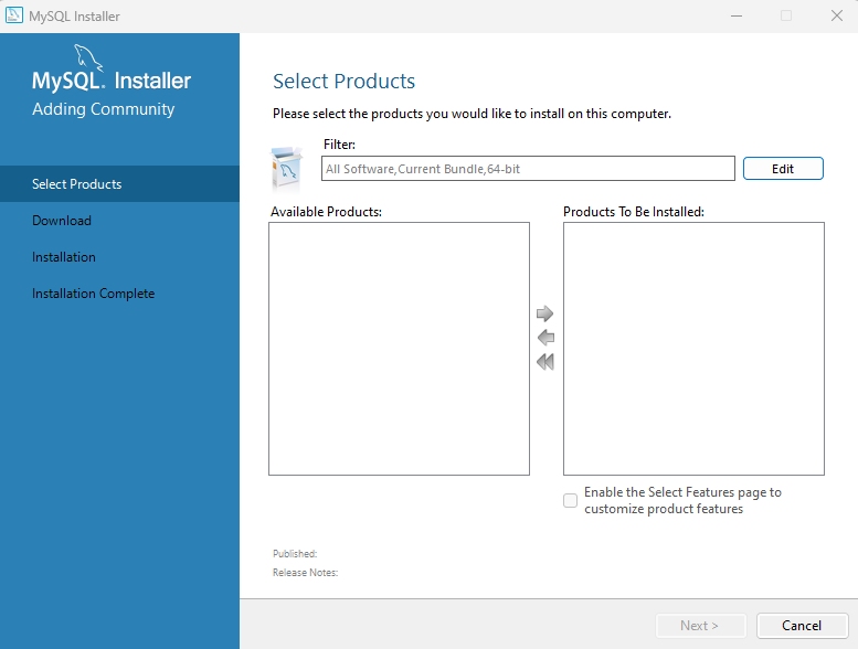

That's where it goes wrong with me, I have a different screen than Tom shows in his description.
This is my screen what I get.
Photo Rien.

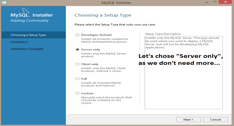

And this is Tom's screen.
Photo Tom.
If I can continue with this, this step is already won (lol).

From what you showed on your screenshot
it is evident that you downloaded incorrect MySQL installer!!!

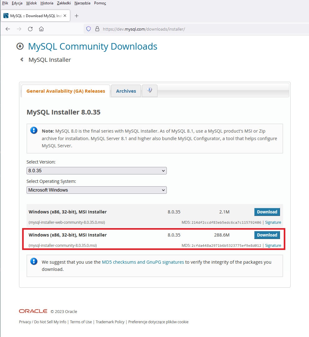

To download proper MySQL Installer use this link:
https://dev.mysql.com/downloads/installer/
No need to dig elsewhere, Hi!
Right now, the up to date version is 8.0.35 __NOT__ the one you sent
"8.20.0" which in fact is "8.2.0 Innovation" but is not visible under above link!

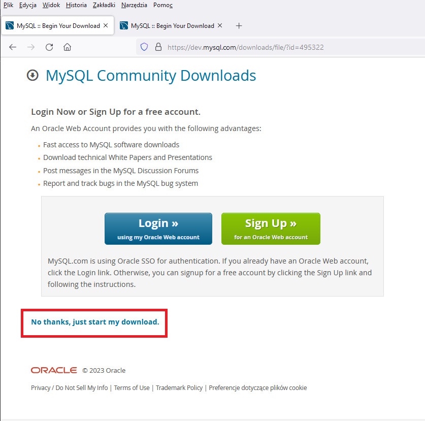

In addition see two pictures attached to this post.
Then simply follow verbaim remaining part of my tutorial.
