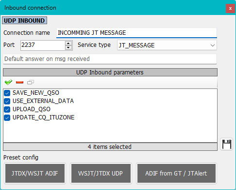

The process is detailed in the latest user guide and was noted in the release notes of version 2.27.0.0 and a search of this forum for 'Delete UDP' returns 39 posts explainining the process.
However here are the steps you should follow:
1. In Log4OM Program configuration go to the 'Connections menu
2. Make a note of the port number being used for your UDP connection to whatever FT software your using.
3. Delete the existing UDP connection
4. Click the Plus sign to add a new connetion
5. In the resulting pop up window provide a connection name, add the port number obtained in step 2 above (This is not neccesarily the port number shown in my graphic) and select the 'Service type'
6. Ensure the four check boxes are checked as shown in the graphic below
UDP FINAL.png (13.6 KiB) Viewed 1597 times
7. Click the small floppy disk 'SAVE' icon at the lower right
8. Click 'Save and apply'
9. Restart Log4OM
You could use the preset buttons at the bottom but I have included the step by step instructions
