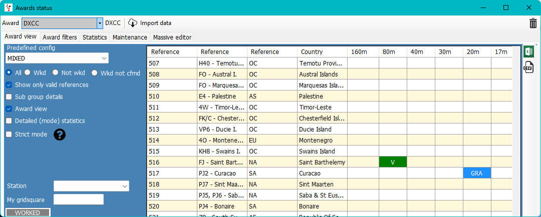

I just tested setting the QSO to submitted and granted using the award status window by double clicking on the entity then selecting the QSO and editing the QSO in the edit/awards tab - followed by clicking the floppy save icon and save and apply
After a refresh I get the granted status as shown below:

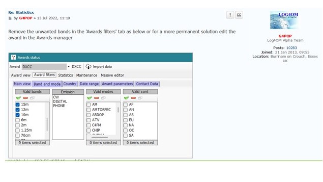

One other thing that might be related. As I mentioned in my original message; the "Awards filter" seems frozen. It was accessible in July 2022 when you helped me with a related issue. Could the "Awards filter" issue be related to my problem of recording GRA for award granted. See screen shot or attachment.
Best Regards,
Danny
AH6FX/W4

Ah! Confirmed the thing is frozen, will ask Lele to checkah6fx wrote: 30 Aug 2023, 14:56 Terry,
Best Regards,
Danny
AH6FX/W4
