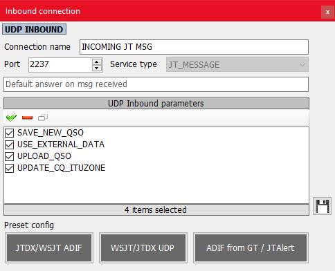

Bob,
From your comments it sounds to me as if you have not properly removed and "re-installed" the UDP Inbound Connections after the installation of V2.27.x.x.x.x and especially V2.28.
At the very least check what options you have selected for the UDP Inbound Connections that you use for your FTxx data input.
The Use_External_Data option "must" be selected for Log4OM to then pull the QRZ.com data into the empty fields coming in form the FTxx APPs.
The Upload_QSO option "must" be selected to then have the QSO flagged the upload routine to the External Services (LOTW, QRZ.com, Clublog, etc..)
See sample image below.
Then when you do your manual uploads via QSL Manager the "N" will be flipped to a "Y" once that upload is completed.
You may have already deleted and did a fresh installation of the UDP Inbound Connections, but maybe you did not select the Use_External_Data option.
You should not have to 'massage' any QSOs after the fact if the options are chosen for the UDP Inbound Connections.

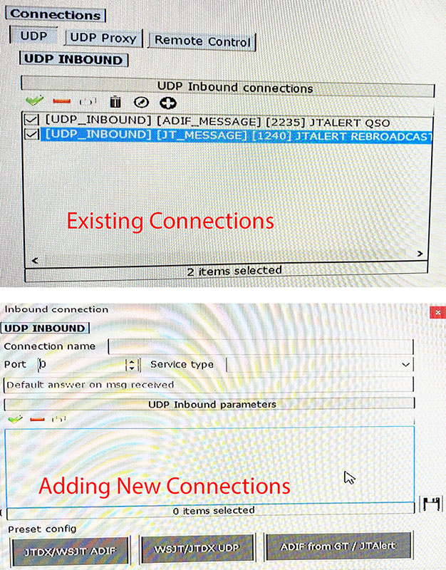

I realize that I need to make the required updates, starting by deleting the original UDP connections.
My existing connections are shown in the photo. After I delete these, I select the “+” which gets me to the second photo.
At the bottom of that screen I see 3 Preset Config selections. Here’s where I’m totally confused.
1. Do I need to set new connections using all three?
2. Since my existing connections do use two different ports, Can I assume I’ll be be using at least two of the three preset configs?
3. I’m using WSJT-X with JT Alert. Sorry to call out to you again, but I don’t want to start making changes and break something in the process.
