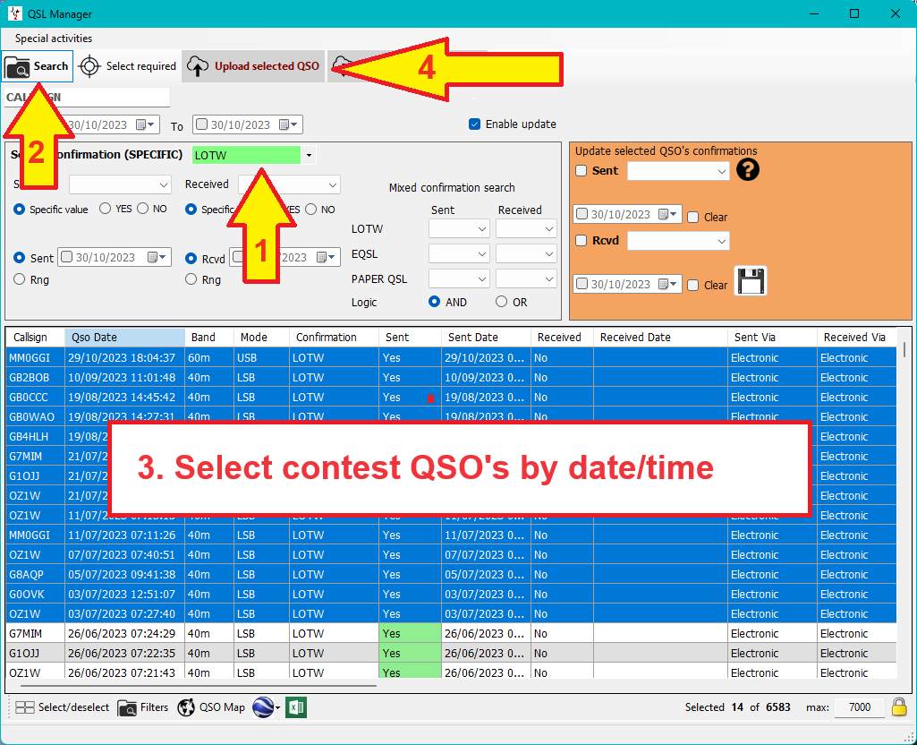

In QSL Manager
Otherwise..................................
In QSL Manager
Re: How to upload Lotw after importing a n adif file??
Thanks for your answer, but when I do this way, no qso appears in the window... What can I do??

You must have a filter set like 'sent' no, make sure all filters are off before selecting 'Search' not Requiredhb9gur wrote: 30 Oct 2023, 08:21 Thanks for your answer, but when I do this way, no qso appears in the window... What can I do??
Sorry have a look at the jpg inclued, if it is right, it still doesn't work..
- log.jpg (81.5 KiB) Viewed 3931 times

You have NO in the sent field remove it and try again the 'SEARCH' button
Ok with "nothing" in set I got 2 qso that have uploaded one by one.
With "no" = no qso
with "requested" = no qso
with "queued" = no qso
with "yes" = the same 2 qso as with "nothing"
with "invalid" = no qso
Thanks for your great help
With "no" = no qso
- log.jpg (101.17 KiB) Viewed 3927 times
