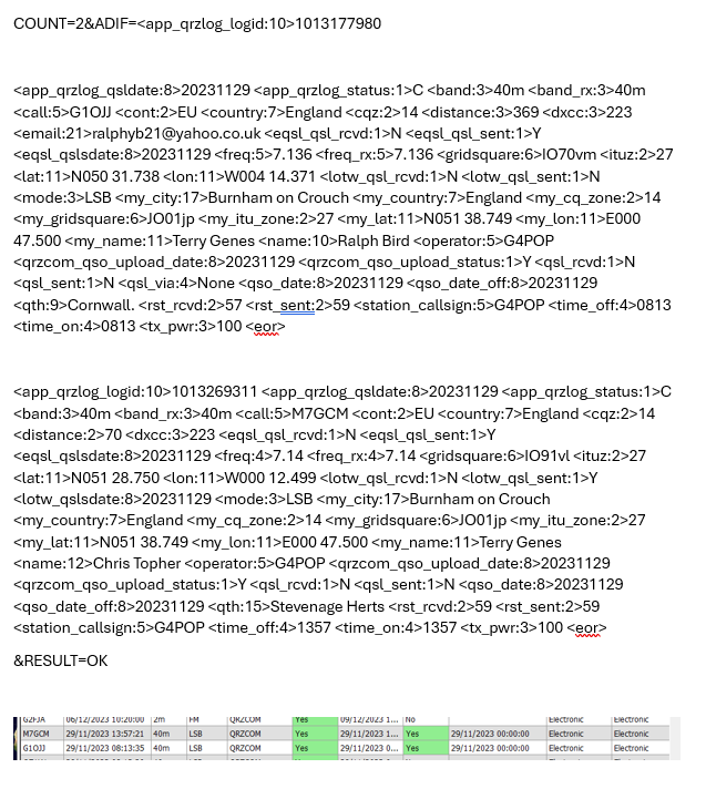

I am using the latest Beta release https://www.log4om.com/l4ong/release/be ... 5_beta.zip and I cannot emulate your issues its working fine for me and marking the QSO's accordingly.
I have however asked Lele to check this topic and comment
See my image below
See my image below
