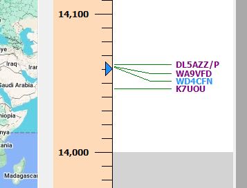

I thought of that after my post and renamed it, but I still see 14.000 as the lower limit to 20M. See attached.

Yes I did. I've attached a screen capture showing the 20M lower limit at 14.000. BTW thanks for taking the time with this.

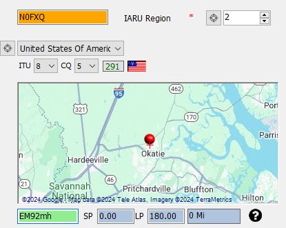

I have tested this function twice now and its working fine so its something your end, have you got your region selected correctly in the Station info?

I checked the file name and made sure it was an underscore - it was. Changed the lower limit for 20M to 14.100, restarted, there was no change in the Spot View at the right side of the Main window. I've attached my station info. I think it is OK.
