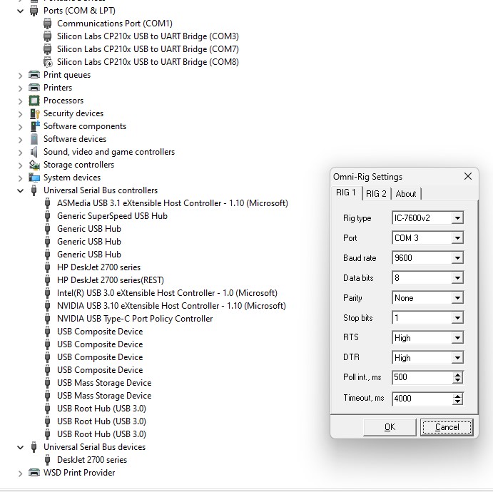

I'm using Log4OM2 V 2.32.1.0 with an Icom 7600 and 9100 connected on separate USB cables to the pc. All worked perfectly for years and then I got a bonehead idea to try WSJT-X. The install worked and I played with it but then I shut it down and went into Log4OM2 and it messed up the connections on both radios so I got frustrated and removed WSJT-X but (of course) that didn't fix it. I was able to get the 9100 to connect by changing the com port to com7 which apparently Windows 11 did when I removed the WSJT-X program but still don't have connection on com 3 with the 7600 via omnirig. I love this logging program and don't want to change to something else but I don't want to go back paper & pencil either. Please help. Thanks, Jack

Could you post a screenshot of your device manager showing the com port list?
Re: Com port issues with wsjt
This is with both rigs and Log4om running. Com3 pops up with 7600, Com7 & 8 pop up with 9100.
Dissconnect the two radios from the PC
Reinstall the genuine Icom USB drivers
Reconnect radios
Ensure 7300 Baud rate matches that set in Omnirig
Reconnect radios
Well that worked thankfully. I appreciate the expertise.
