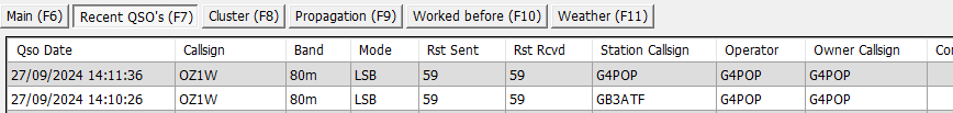

When using Net Logger, I can set up different "Station Locations" Within these Station Locations I list a Station Name, my Station Call Sign, DXCC, State, Country, ITU Zone, CQ Zone, Grid Square, City, Country, /M or /P, and there is a check box to enable a club with Club Call Sign, and whether the club is /P or /M, further I can enable an additional call Sign which would be the Special Event.
When I log a contact with someone Net Logger will log a separate line for each of the Call Signs I have along. IF it is me and a club, there will be two QSO's logged if I have me the club and a special event there will be 3 QSO's logged See Station Setup Screen shot below.

- Screenshot 2024-09-27 141755.jpg (71.05 KiB) Viewed 943 times

I am exporting adif files to a home-brew logger for backup that also uses the station setup system that allows me to check that a contact was with both my call sign and that of my club. I agree that the identical time stamps is what is forcing the duplicate entry to be rejected.
I went into NL and changed the time stamp by 2 seconds and both qso's were imported into Log4OM.
