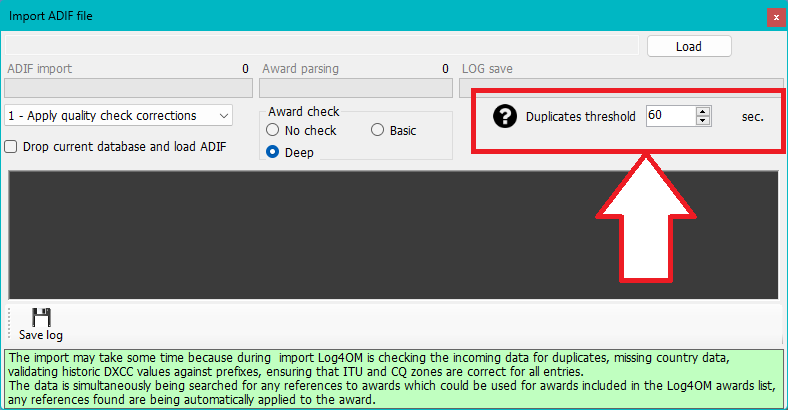

This problem is due to the fact that with WSJT you can have a new QSO every 15 seconds and QSO's on the same band and mode on the same day and withing 30 seconds of each other are suspected of being duplicates.
Log4OM does not want to create duplicates in the database so rejects those QSO's and reports them as 'Not being unique' in the log file.
So the import window shows the number of QSO's in the ADIF file but ignores those too close in time and rejects them - Hence the different count during and after import.
To overcome this we have included a user defined time threshold in the ADIF import window! Please set this to 60 seconds to avoid these WSJT contacts being considered dupes - See below

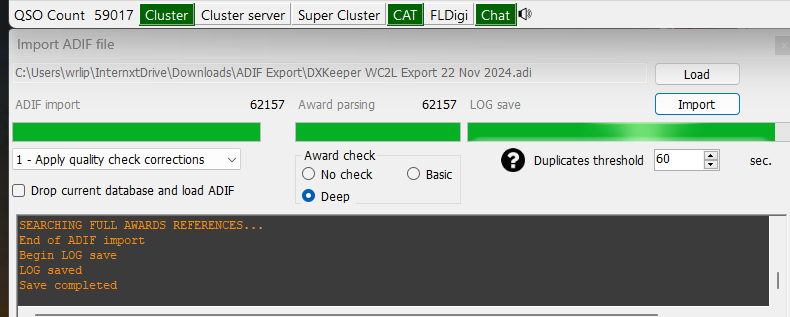

Re: ADIF Import - Lost Qs issue
Post by WC2L »
I may have had enough!
Log4OM Import.png (37.16 KiB) Viewed 1136 times
