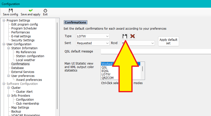

K2DJL wrote: 13 Feb 2025, 21:38 Also, when I try to change anything in the "confirmations" tab, it automatically reverts back to "no" in sent and received tabs. Thanks again, Dan K2DJL 73
You did do the save using the small black floppy on confirmations page, followed by save and apply didnt you?

Post by K2DJL »
Hi Terry:
Thanks for the help. I think my saving sequence with the floppy click and "save and apply" was off. It is uploading to LOTW now "Automatic upload on application close". For some reason I thought that QRZ would show the upload without having to click the "Import from LOTW" button in QRZ. Anyway, thanks again and best 73s. Dan K2DJL
