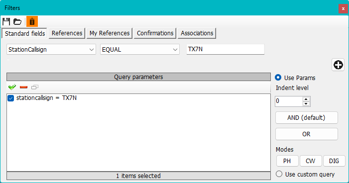

If your using a file generated by another source you should use ADIF master to ensure that the CORRECT 'Station call sign' is recorded for those QSO's
Then when you have imported the EDITED file to Log4OM use a filter as I described above to sort just the calls with that SPECIFIC 'Station call sign' in the QSL manager
Once filtered so then mark the Confirmation status according to your requirements
