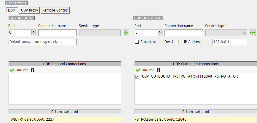

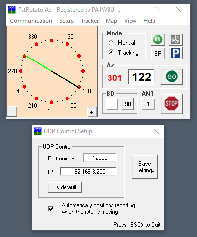

FWIW, this is what I use:
and
Note that I did not have to change the PSTrotator config from what I used on L4OM V1. "Just worked" out of the box with L4OM V2.
Hope it is of any use to you.
73 Wilko

Note you are showing you are using UDP Port 12040 in Log4OM2 and 12000 in PSTRotator. They should both be the same!
73 Peter G3ZSS
