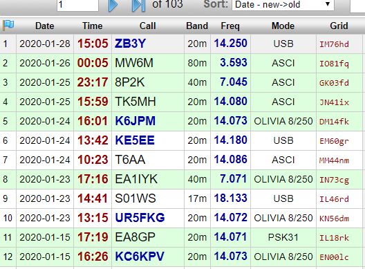

Trying to identifiy the root cause of this issue.
Logged in Log4OM like this
That's the log on QRZ.com
Just for a test I deleted this QSO with TK5MH from QRZ.com which initially was uploaded automatically from Log4OM.
Then I manually exported just this QSO from Log4OM to an ADIF file. Content looks ok, frequency is still correct
...<FREQ:5>14.085....
Then I manually imported this ADIF file on QRZ.com, again showing the wrong frequency.
