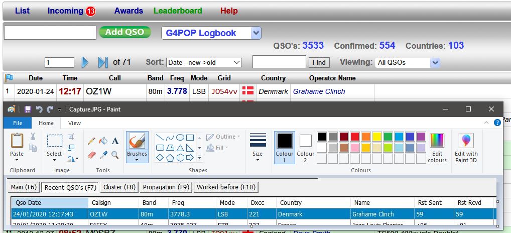

I missed that it was 8Khz it round the Hz as in my image below.
Does this happen every time?
