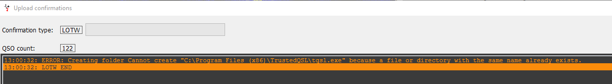

First time trying to upload to LoTW using QSL Manager. Getting an error saying "Creating folder cannot create........" see attached for full error pls.
73 Ras VK2QV

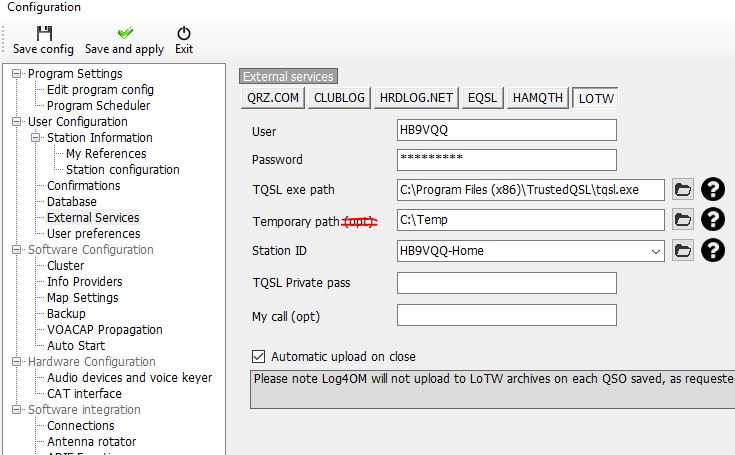

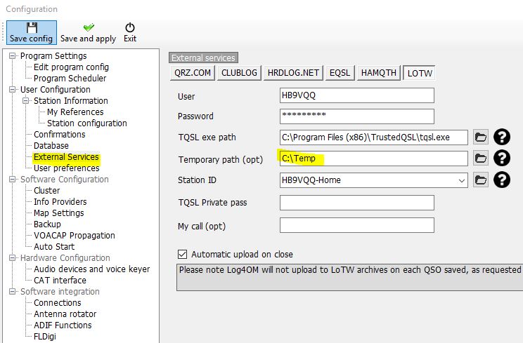

do you have a temp. path configured in External Services --> LOTW ? If not do so and try again.

This is interesting. I've not tested without a Temporary path being specified but on page 71 of the User Manual it says a Temporary path MUST be specified. However, in the window where you would define this path it shows as optional (opt). Is this a documentation error or does the window need to be corrected?

Hi Tom,
yes you are correct, documentation info vs. actual config window are not aligned (yet). It was not working for me without temp path.

Thank you Roland. Set the temp path. All working fine now. 73 Ras de VK2QV
