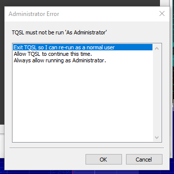

Here is the error I receive when I upload my logs to LOTW. Turning off Administrator Privilege's I do not get this error.
It is asking to choose one. My question, is it OK to chose the last selection 'Always allow running as Administrator'?

k4em wrote: 10 Aug 2020, 00:56 Here is the error I receive when I upload my logs to LOTW. Turning off Administrator Privilege's I do not get this error.

Personally I would exit and reset the run as administrator settings in Properties but its your choice
