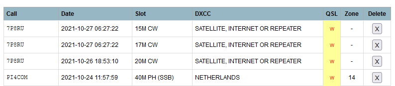

Hi all,
I have manually inserted in Log4OM 3 QSOs with 7P8RU but on ClubLog the DXCC field is recorded in a wrong way while, for example, on HamQTH the country name is right, Lesotho.
Is it because of me or about my program settings that the data are transferred wrong to ClubLog?
Note: do not pay attention to the time of the last 2 QSOs, it is the same but it was my mistake to have left it in manual instead of automatic when I inserted them in Log4OM
Wrong DXCC field value on ClubLog

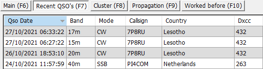

Re: Wrong DXCC field value on ClubLog
In Log4OM it's Lesotho.
Note: in Log4OM I have corrected the time of the last QSO after it has been uploaded on ClubLog

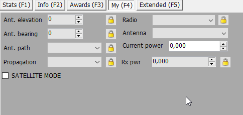

suggest that you check if you were in sat mode when you saved the QSO's
If you mean the "SATELLITE MODE" checkbox, it was unchecked.

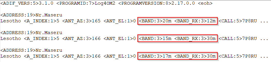

The adif exported from Log4OM for that QSOs has differences between BAND and BAND_RX fields values.
I edited it before uploading it to ClubLog.
I'm using the 2.17 program version.

So it seems we stopped the freq issue but not the band issue will add it to our Mantis list
- Posts: 2988
RX band is set only when explicitly set (when CAT is not connected)
If you set a RX band while in manual mode, it will be kept until you remove it.
RX Band is user selectable and accepts also a BLANK value. If a non-blank value is set it will be kept...
I've made some checks on that but everything seems ok to me. Can you please give me more info?
I did not set manually the RX band.
However it may have happened that I turned on and off the CAT more time.
Could it have happened that in manual mode the RX band has been kept so as was the last time CAT was on?
