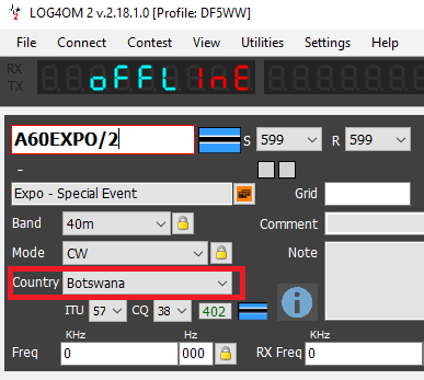

I'm entering the callsign A60EXPO/2, a UAE special event callsign, and it correctly displays UAE as the country until I type in the /2 suffix. This changes the country to Botsawana. It seems that adding a number suffix changes the country. Actually adding a valid country suffix also changes the country. Is this correct?
A60EXPO = Bahrain
A60EXPO/2 = Botswana
A60EXPO/EI = Ireland
A60EXPO/2/A6 = Bahrain
Incorrect country displayed

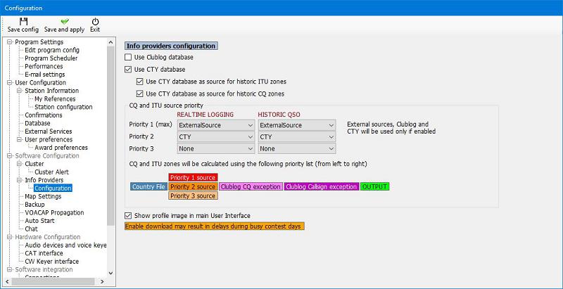

Re: Incorrect country displayed
Juergen,
I was using V2.18.0.0 and just updated to V2.18.1.0 to verify and the A60EXPO/2 is resolving correctly for me.
Likely due to my Info Provider settings. See screen clip below.
- InfoProviders-medium.JPG (55.94 KiB) Viewed 1711 times
Juergen,
Just did some more testing. I disable my QRZ external search and made HAMQTH as prime for external Info Provider.
Then I get the "non-UAE" countries.
Information at HAMQTH is not updated it appears.
Juergen,DF5WW wrote: 02 Jan 2022, 18:51 That could be possible. I have clublog in my provider settings and in thise case my settings
are different from yours. Will give it a try in the next days. Tomorrow the QRL starting again ...![]()
By the way, i don´t have QRZ active, only HamQTH. I´m not a QRZ subscriber ...![]()
I just tested again with QRZ and HAMQTH "disabled" and having Clublog active.
I did NOT get the UAE.
Maybe only QRZ is correct with this one ???
